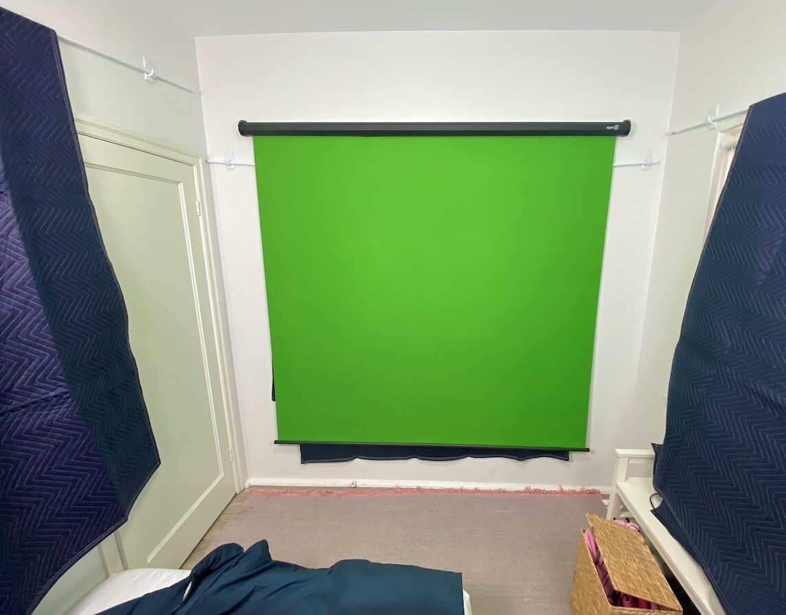

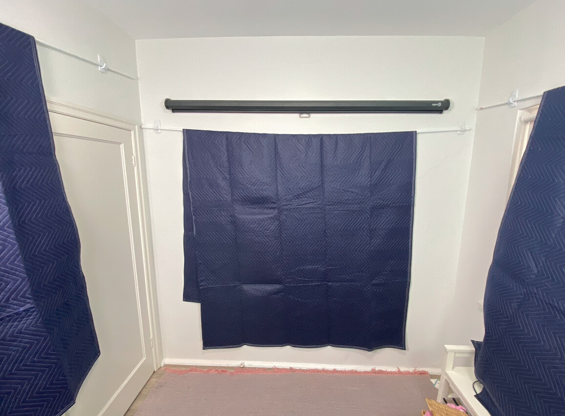

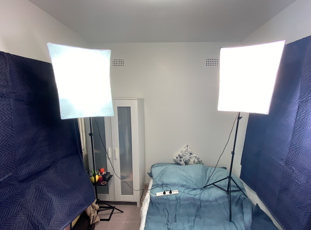

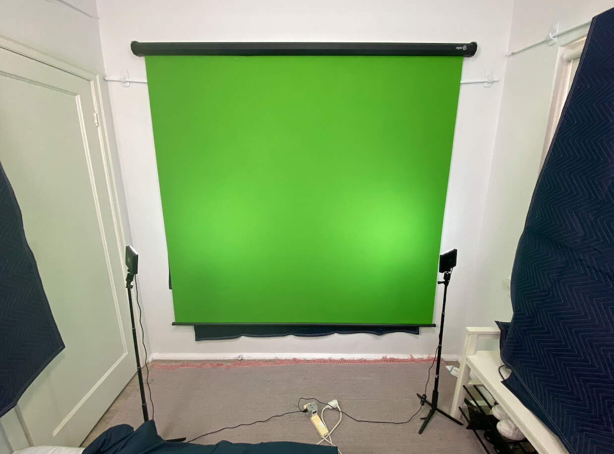

Hey Koz,
Thanks for all the help, I’ve finally got there. The blankets have made a big difference, now I just have to get the lighting and sound post-production right! It’s never ending. I thought I’d send you some pictures of my masterpiece :laughing: and I did a quick video to show the kind of thing I’ll be doing. I’m about to record an online mindfulness course, so I’m just gonna use a simple white backdrop so it’s not too distracting. I’ve put a sample clip here in my dropbox.
Also, I’ve done the best I can with the audio, the raw file is here - Dropbox - ZOOM0176.MP3 - Simplify your life
I wonder if you have any ideas about how it sounds or how I could make it better? With a lot of youtubing (although I don’t completely know what I’m doing) I managed to get it to sound better.
