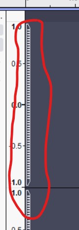

What are these lines in 3.7.5?
Using Audacity 3.7.5 on Win 11. While editing a project I inadvertently moved the playback level meter to a new toolbar (below the main toolbar). When I did that these lines appeared (see the attachment). They show up at the beginning and the ending of my audio track. I’m not seeing anything in the help files referencing them (I probably missed it somewhere). I didn’t see anything in the options that seemed to refer to them. I do not see or hear that they audibly affect the results of the project but am curious what they represent. How do I get rid of them (moving the playback level meter back didn’t remove them)? Any help is appreciated. Thanks!
Multi-tool has been engaged … Multi-Tool - Audacity Manual
Awesome! Thank you!
