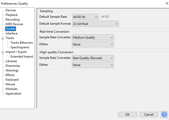

When you said that you had turned off dither in Audacity, it appears that you haven’t - perhaps you turned it off in the “Real-time Conversion” settings but not in the “High-quality Conversion” settings.
The “Real-time Conversion” settings has dither set to “None” by default. This affects playback only.
The “High-quality Conversion” settings has dither set to “Shaped” by default. This affects exporting and mixing to a lower bit-depth.
Ref: Quality Preferences - Audacity Manual
You are right. My eyes mixed up “Real-time Conversion” and “High-quality Conversion”. This time I disabled dither in the “High-quality Conversion” section. I also did the process again (with a new recording) just in case but this time dither is set to none in “High-quality Conversion”. If you want I can make a recording in Audacity and a separate recording in Goldwave as well.
Also, I am attaching pictures of the settings I have in Audacity and Goldwave if it helps.
