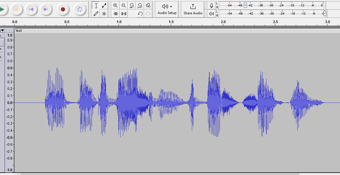

half wave display

Thanks, @Trebor - unfortunately the “half-wave” you posted the screenshot of has nothing to do with this issue.
For 15 years my waveform has filled the virtually the entirety of the track, vertically. No longer.

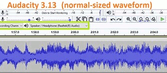

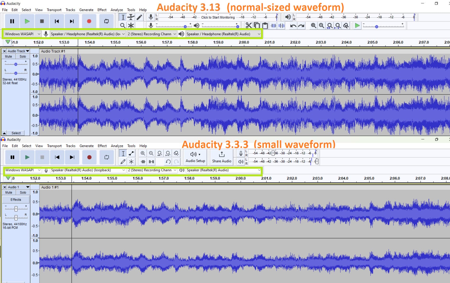

Maybe Audacity isn’t “to blame” but many other people have reported this…phenomenon…whomever’s to “blame.” I just fetched an old laptop with a previous versions of Audacity.

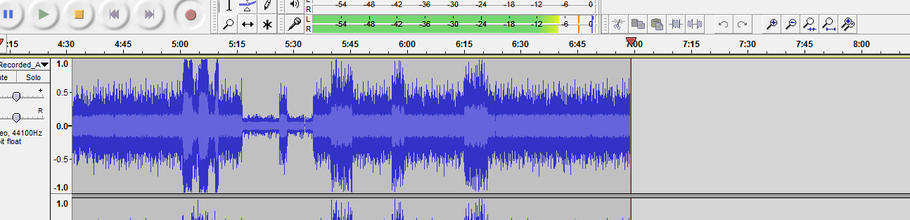

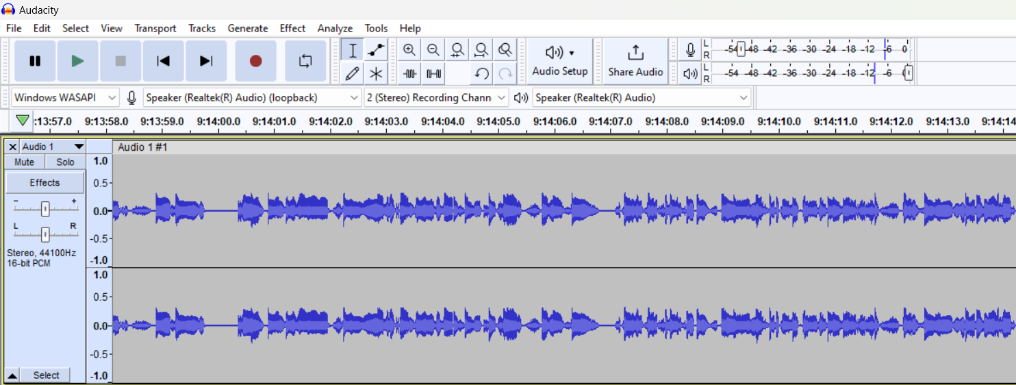

I played the same content at the same time on my previous and current laptops simultaneously. In the screenshot you will see the audio clip at precisely the same spot with same output/playback volume/amplitude----but see difference in waveforms. Top is what waveforms looked like for 15 years–bottom is current display.
It’s not just a smaller version: the envelopes are slightly different …
envelopes are different

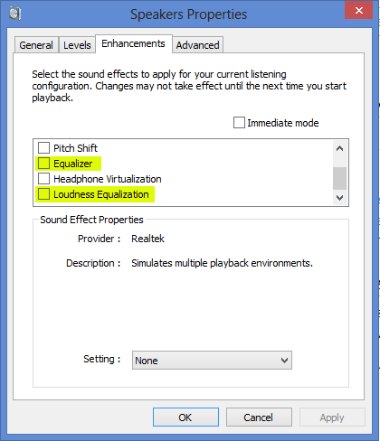

Your newer Windows computer, (running Audacity 3.3.3), could be applying a playback audio-enhancement which is responsible, e.g. “Loudness Equalization” …
playback audio enhancements in Windows
(such enhancements can be on by default).
If you are recording the output of the computer such enhancements are baked-in to the recording.
Here’s how to turn them off … https://youtu.be/eXGyAzk3fd4?t=49
hi @Trebor - thanks again - appreciate your thoughts. Wish that were it, but enhancements long ago were set to off. that’s not the issue.

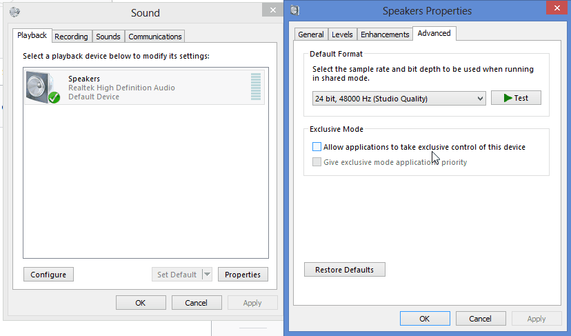

That you’ve used some app (in the last week) which has taken “exclusive control” of audio, (e.g. Skype, or Zoom), and it wont let go …
RealTek playback enhancement and MaxxAudio are the only things on my Windows machine that can effect the the WASAPI “loopback” sound recording …
Well…that’s not it, but thanks for your thoughts and suggestions. I guess it will remain a mystery to me and subsequent inquiries on this topic that will inevitably come through.
