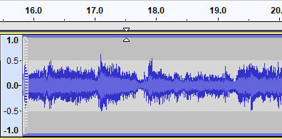

This is the trace.

You currently have the “multi-tool” selected. To go back to the normal “selection tool” (and the normal view of the audio track), either click the “I” icon button, or press the F1 key. (Multi-Tool - Audacity Manual)
