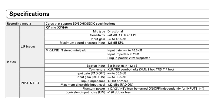

The specification page tells us the H6 can supply Phantom Power of 12 volts, 24 volts, 48 volts or Off. Where’s is yours set?
Off for all channels
Then that’s not it.
