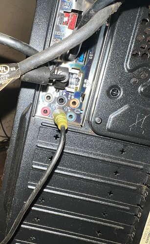

S/PDIF is a digital audio connection standard. I thought it might be labeled on your computer. It was standard on DVD players before HDMI “took over”. The optical standard (also S/PDIF protocol) is called TOSLINK.
These are the connections on my desktop. The green mini-jack goes to the speakers.
It might be an issue with Windows, or maybe the drivers. If loopback doesn’t show-up as an option (for the speakers), I’m pretty sure it’s not a Audacity issue.

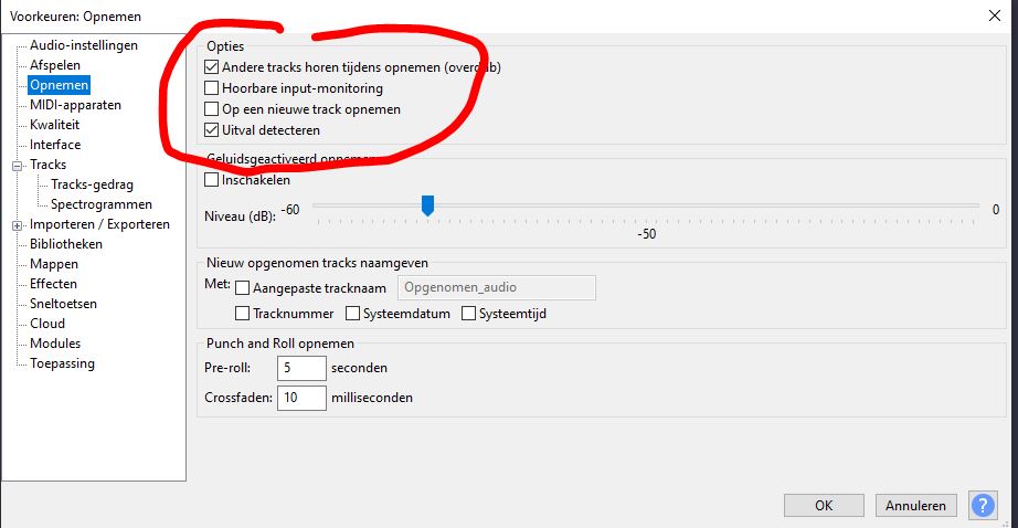

What might work for you is to check your preferences in Audacity via ‘Edit > preferences > record’ … from the 4 first boxes I only checked the first and last one (see picture). Maybe it helps?
