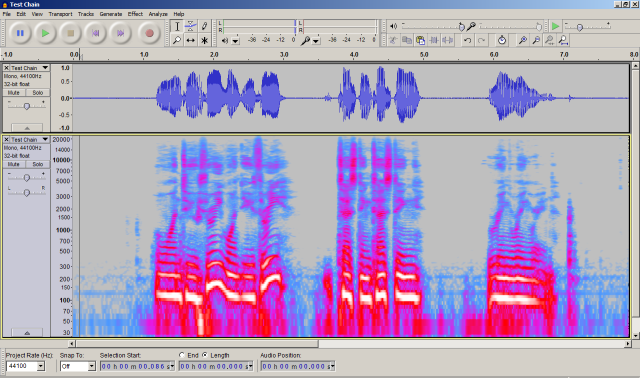

That screenshot is a waveform display. If you select spectrogram display it shows the frequency-content in multi colours …
Excellent! Thank you so much for your help, I really appreciate it!
