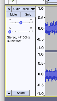

Audacity can have magic problems as well. Say you accidentally bumped the L/R panning control to the left of the stereo track.
The blue waves would have you believe the stereo track is still in terrific shape, but the bouncing sound meters will be missing the right channel (in this case) and you will hear no right sound.
It gets much better. If you have a mono show (one blue wave) and bump the L/R slider, Audacity will create a stereo show in the background. You will still have one blue wave and the info panel will still say mono, but he sound meters will tell you you have an unbalanced stereo show and if you export it, it will be an unbalanced stereo sound file.
