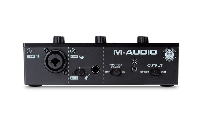

Does your “decent microphone” require phantom power ?, (i.e. is it a condenser mic).
Is the phantom power on the interface switched on ?.

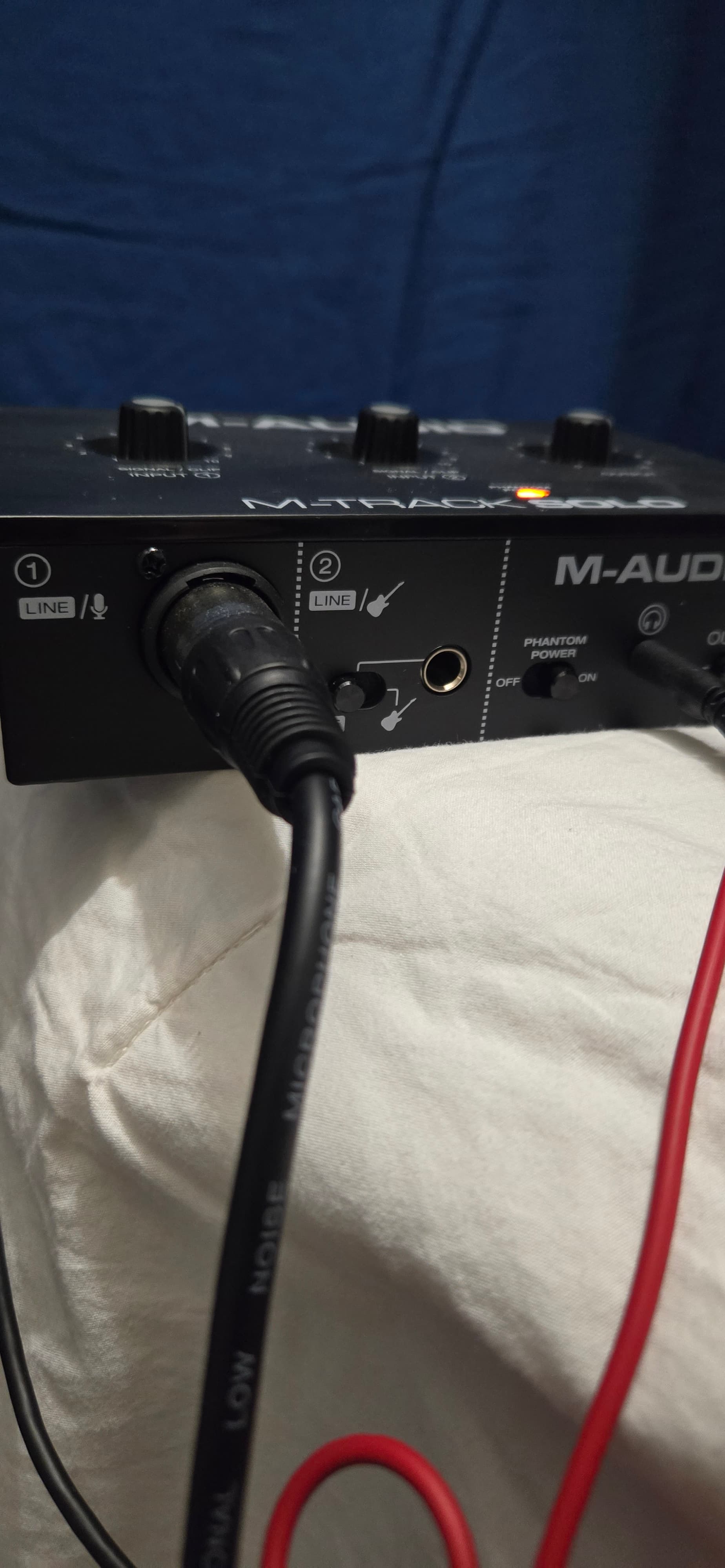

Yep, its on.
Big plug is connected to mic and small red one is connected to headphones. Troubleshooting now. Interface is connected to my laptop via usb

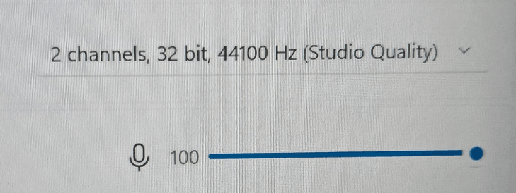

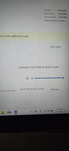

M-Audio interface spec is 2 channel 48000Hz 16-bit …
https://m.media-amazon.com/images/I/A1CJsuHRh0L.pdf #
(also set Audacity project rate at 48000Hz).
