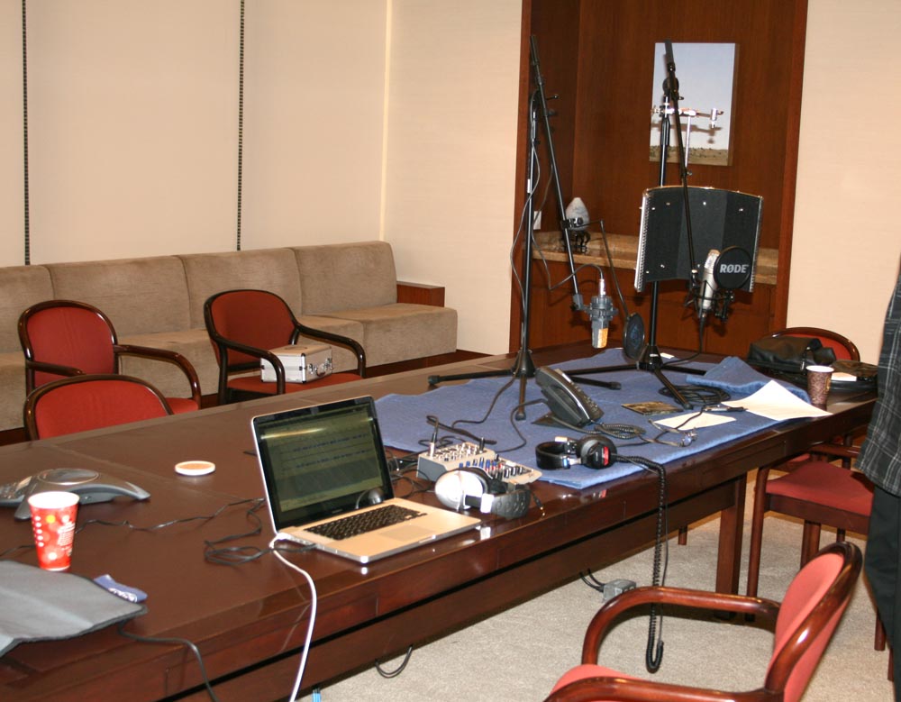

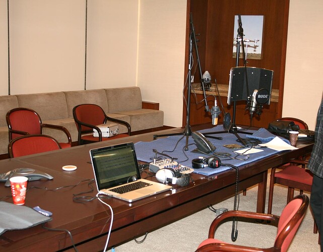

This is a broadcast radio shoot I did at work. The producer being interviewed knew I was going to go crazy, so I did. I got the Executive Conference Room because it’s soundproofed. In effect, I shot it in a studio. We double recorded it against equipment failure. I recorded it on Audacity. We got to the end of the interview, I exported a sound file and shipped it to the radio production facility. And we all went to lunch. Badda Bing.
