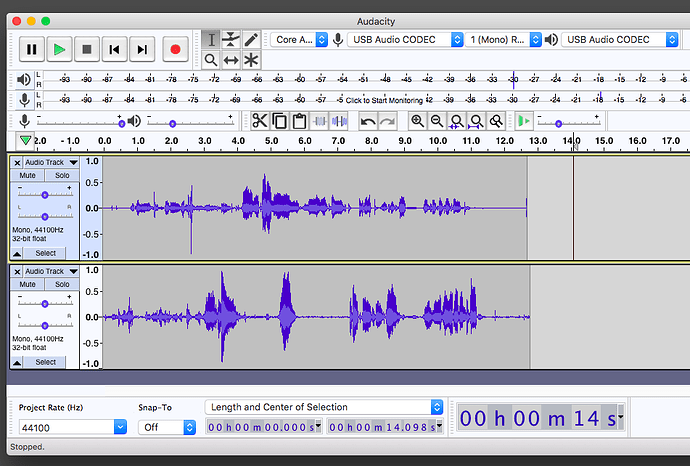

I pressed the Audacity red record button and recorded a simple voice track. The bouncing sound meter bounced and I got a new blue wave track. You may not hear anything right now. It depends on your interface.
Stop.

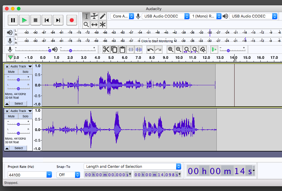

I pressed record again and I heard my first voice playing in my ears while I was recording a fresh new voice at the same time.
Stop.
I now have two voices one above the other and I can play them both at once or SOLO one or the other.
If I pressed Record again, I would get a third track while I was playing the first two.

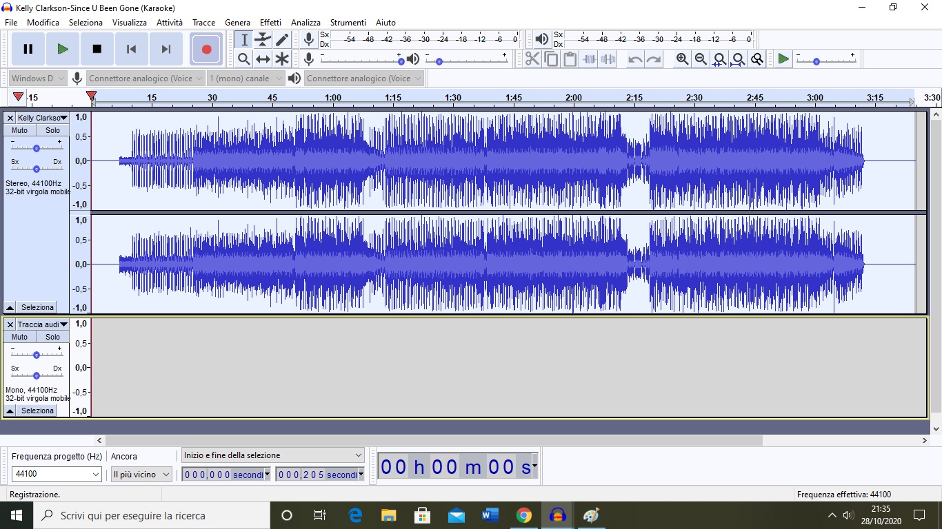

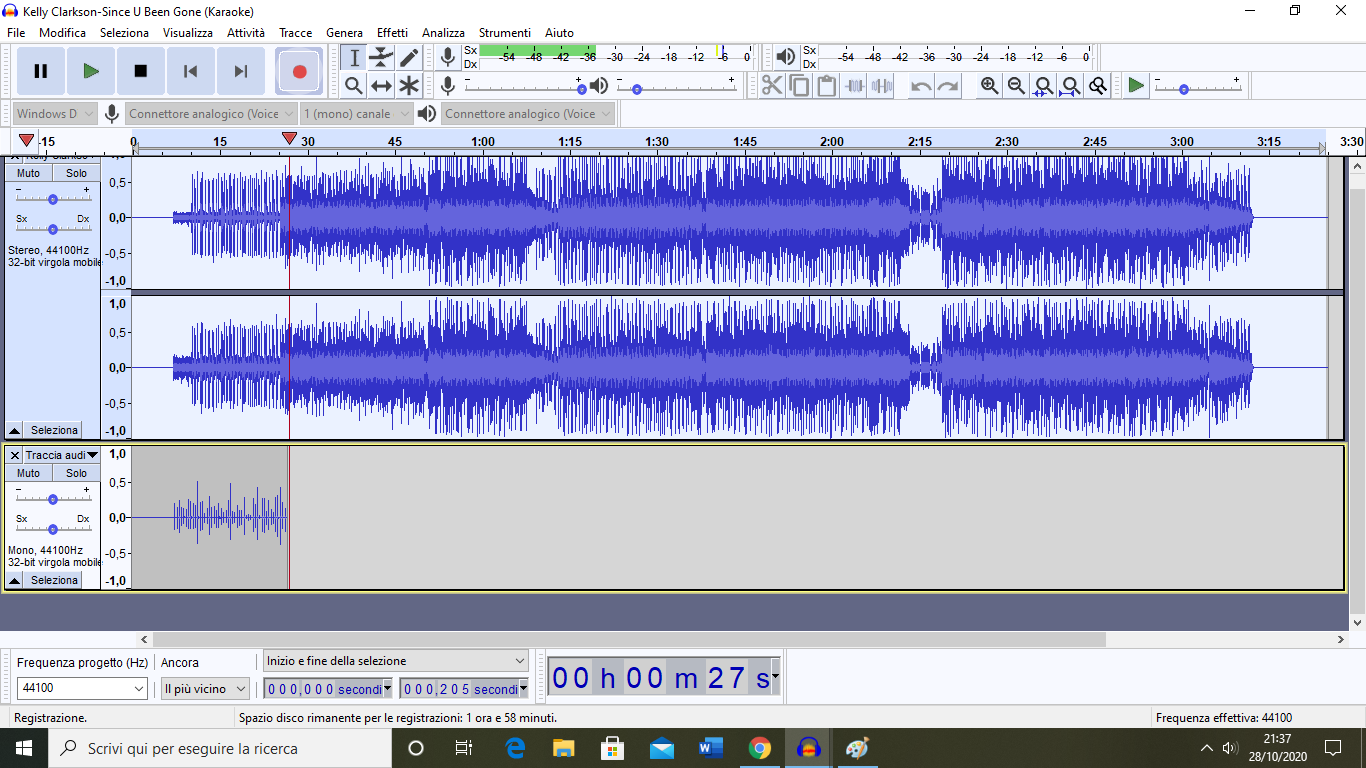

I’m gonna show what I see when I try to record a new vocal track on a instrumental track I’ve loaded on Audacity. So:
When I don’t select the Overdub option and I try to record a new vocal track, of course I can’t hear the music playing in my headphones but I can hear my voice at the microphone and the computer can also recognize the recording as you can see from the microphone monitor. After I stop the new recording and I play both tracks at the same time I can hear both the recordings synced in my headphones.
But when I select the Overdub option and I try to record a new vocal track again, this is what happens:
In this case I can’t hear neither the instrumental track nor my voice in my headphones while recording, and the computer does not perceive the mic and my voice as well. Also the tracks seem to be freezed as the cursor is stucked at the beginning of both tracks. When I stop the recording and I play both tracks at the same time, I can only hear the instrumental one, while my new vocal recording doesn’t play and seems to be not recorded.
