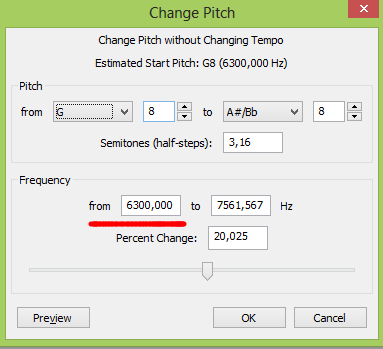

I went to Effects → change pitch
what does the underlined field mean?

You can try [u]Analyze Spectrum[/u].
As you may know, the human voice (and most natural sounds) are made-up of many frequencies. The lowest or “fundamental” is most-associated with perceived pitch. It will probably work best if you select a vowel sound to analyze.
And of course, when you are speaking or singing the pitch is not constant.
