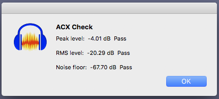

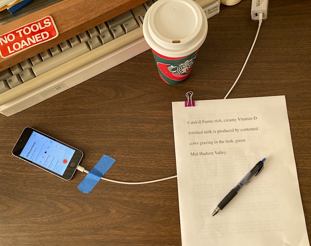

See, we’re not making this up. I read a sound test in my quiet office with my old iPhone.
I used ordinary Lossless Voice Memo. I transferred the sound file over to Audacity, cut it down to size, mastered it, and applied very gentle noise reduction.
It passes Audacity ACX-Check…

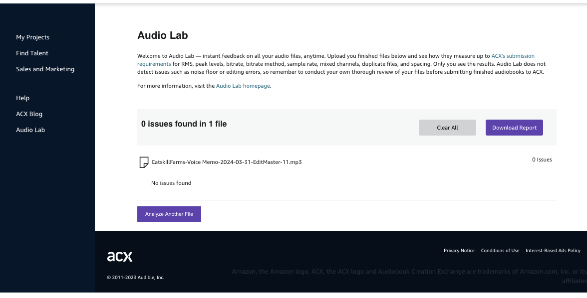

…and the on-line ACX Audio Lab.
None of these tests check for theatrical errors. if the track doesn’t sound very good, it’s not going to pass the ACX Final Inspection before publication.
This is from ACX:
…remember to conduct your own thorough review of your files before submitting finished audiobooks to ACX.
It’s our note that if you can pass ACX Audiobook, you can submit to anywhere else.
