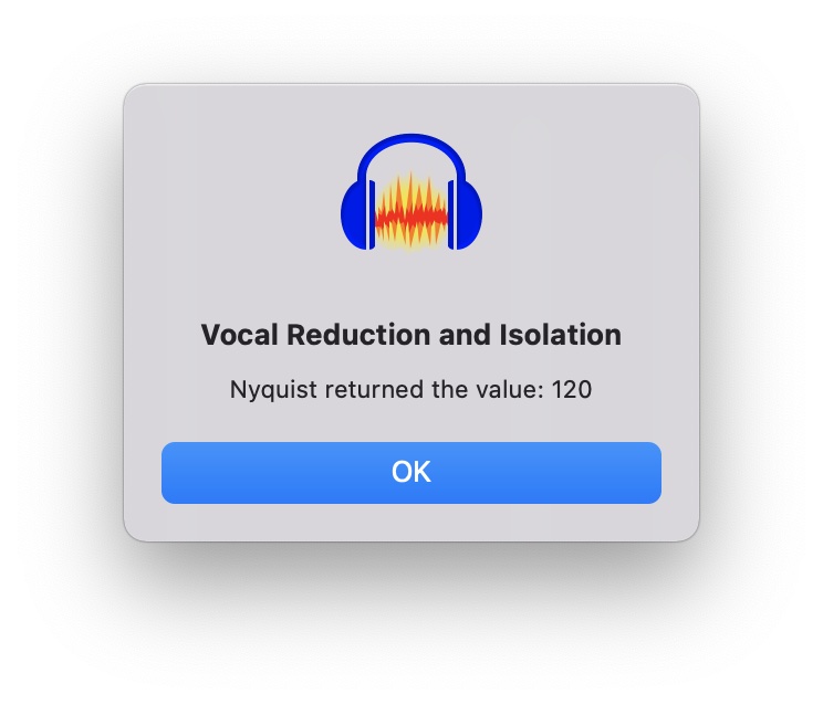

Now I’m trying to remove vocals from a song, but whenever I try I receive the message (enclosed) “Vocal Reduction and Isolation - Nyquist returned the value 120”.

In debugging, after receiving the message “Vocal Reduction and Isolation - Nyquist returned the value 120”, if I click on OK i see the message “error: unbound function - GET-DURATION”.
