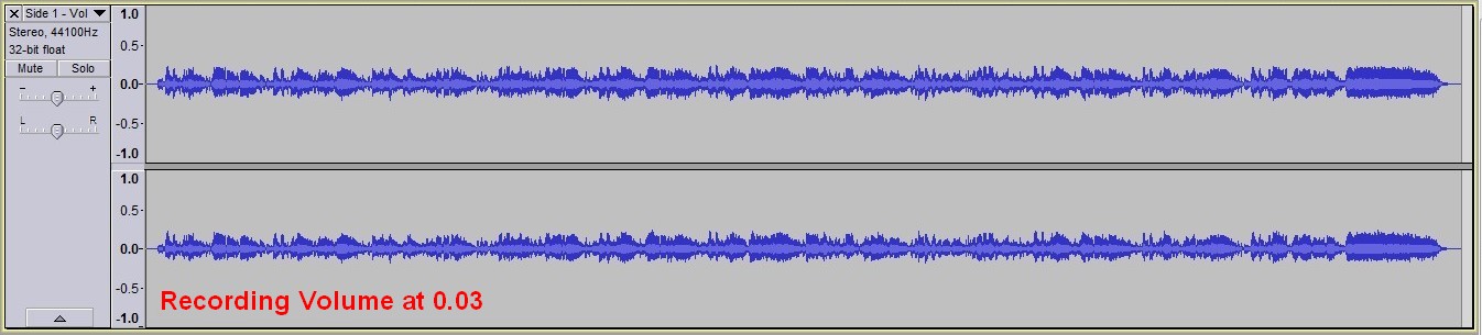

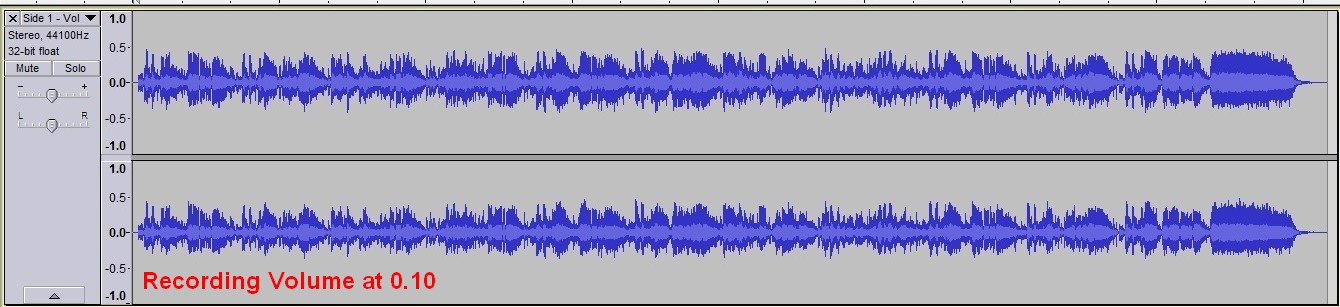

I recorded the same song at different recording levels (0.03, 0.05, and 0.10), then used a dynamic range meter to measure the results (Below are the results). If I got this right, the optimal recording level would be at 0.10?
DR Peak RMS Filename
DR11 -12.39 dB -24.97 dB Side 1 - Volume at 0.03.wav
DR10 -10.91 dB -23.40 dB Side 1 - Volume at 0.05.wav
DR10 -6.41 dB -18.94 dB Side 1 - Volume at 0.10.wav
0.10 looks good.
Given that the signal level is pretty constant, you could perhaps push the setting to 0.15, but 0.10 is OK.
On your set-up, over 0.15 would be too high. Under 0.05 is too low.
Note that changing anything in your recording set-up could have an effect on the recording level (including playing a different record), so don’t just blindly follow the numbers - check to see what level is being recorded. The “0.10” image looks good, or could be a “fraction” higher, but not much higher - you need to retain a bit of clearance between the blue waveform and the top / bottom of the track. So long as there is some clearance, the exact level is not very critical.
The dynamic range measurements don’t make sense and I don’t believe them, or at-least I don’t believe they are meaningful. Maybe there is a click or pop that’s hitting 0dB (1.0 on the Audacity waveform display). That could throw-off the measurements/calculations. Or maybe there’s something else wrong with the measurement/calculation.
If you clip by “trying” to go over 0dB (higher than 1.0 on the Audacity waveform scale) you loose dynamic range. Otherwise, the dynamic range capability of 16-bit audio is more than 90dB and 24-bits is more than 140dB. You loose a little of that rage at lower levels, but adjusting the volume linearly (without distortion) doesn’t change the dynamic range of the program/music.
