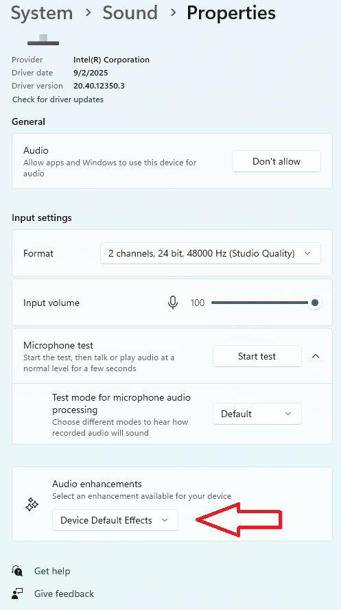

Make sure Windows “Enhancements” are turned OFF.
They can foul-up the sound in lots of weird ways. And it seems to be getting very good at filtering-out everything except spoken voice.
Doug, you nailed it! Thank you!
Just attaching a screenshot of the spot where the setting is located, for the benefit of future victims. Set that switch to OFF and you are good to go :grinning_face:
