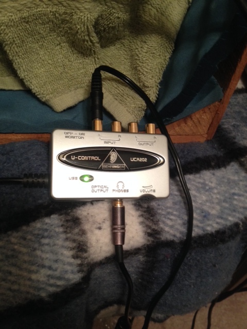

Last night I couldn’t get the wife over there, to work on this, as she’s preparing to travel to her parent’s by plane. Hopefully we can do it this evening. She has the Windows computer and carries it with her, including on this trip. I did order a Behringer U-CONTROL UCA202, as I suspect we’ll eventually use it in our other business as well.

I couldn’t get her to record last night. She got home something like 4 hours late and still had to pack. BUT, I did get her to leave her Windows laptop home with me. She took a Linux laptop instead. I received the UCA202, in the mail today. I will go over the instructions and give it a try, so I can send you a sample. Now I have to go over the directions for the mixer too. I am completely inexperienced with this sound equipment. She, at least, used to be a disk jockey and has a minor in broadcasting.
The UCA 202 is very easy to use. The one really important thing is don’t overload the inputs. Keep the mixer “in the green”. If the mixer goes into the red it will overload the inputs of the UCA 202 and the sound will be distorted. The UCA 202 has no input level control, so you have to control the input level from your mixer.

Here is a link to a file I did using the UCA202. I could not figure out how to get the volume up.
https://www.dropbox.com/s/c9b370w8xx0jsay/UCA202.wav?dl=0

I’m not going to post a clip until we correct the level problem in UCA202. I did some rescue work and I like the sound better and I can’t tell you why.

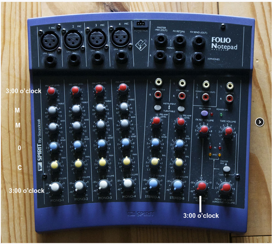

I think you’re just running the mixer wrong. Ummmm. The mixer doesn’t have microphone overload lights. That’s awkward.
Follow the procedure on page 11 of the instruction book to set the microphone preamp control (red knob). I’m betting your earlier painful experiences with the computer connection made you gun shy to turn things up. You should be able to “WOOF” very loudly into the microphone and get the mixer PK (peak) level lights to flash.

My furrowed brow at the missing preamplifier overload lights effectively means you can’t set that control during the show and it’s easy to get crisp, crunchy overload sound and not know where it’s coming from.
Attached, my mixer has two sets of overload lights and I can tell whether the left or right halves of the mixer are in trouble or adjusted wrong.

Forget Audacity for a minute. See Attach. Do you see the red PK and yellow AVG lights on the mixer?
The microphone is plugged into the far upper left connection, right? Set the mixer up according to those notes in white.
3:00 o’clock
Mid
Mid
Zero (0)
Center (C)
3:00 o’clock
Over on the right set the master at 3:00 o’clock. Talk into the microphone in a normal voice. The AVG lights should flash. Now yell “WOOF!” into the microphone and the PK light should flash.

I believe I set all the knobs as you instructed. The volume is still quite low. I never managed to get any lights to blink on the mixer. Could it be that I didn’t “woof” right? ![]()
Another idea: there are two RCA plugs coming out of the mixer, but only one going into the UCA202. Could it be that I need two?
Unplug all the audio cables except the microphone. Shut down Audacity. If you can’t get the lights on the mixer to flash, then the mixer is delivering a substandard show. We need to resolve that right at the top. Nothing you do in Audacity or with adapter cables is going to solve that.
The two yellow and two red lights are there to guide you in setting the volume controls. During a show, the yellow AVG lights should flicker and flash. If you get a red PK light, then your volume is too high. If you get no lights, the volume is too low. It’s not fancy, but it gets the job done.
You got the green Power On light, right? But no flashing yellow or red lights?

You could have a broken or incorrect adapter cable from your illustration. Unplug Everything from the mixer except the microphone.

Ok, I unplugged all cables from the mixer, except the microphone and the power. Then I tried woofing into the mike loudly. The board showed a green light, indicating power. But that’s all.
