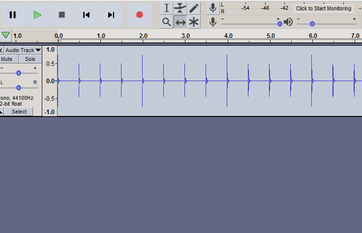

A workaround: use beatfinder on the click track, that gives vertical lines on the label track …
Assuming that your click track is at an exact tempo (generated rather than human), there’s a plug-in for creating labels in bars and beats - the labels can then help with alignment as described by Trebor.
See: https://forum.audacityteam.org/t/beat-per-minute-labels/20785/1
The label generator plug-in is a “Nyquist” plug-in. Up to date instructions for installing Nyquist plug-ins: https://forum.audacityteam.org/t/installing-nyquist-plug-ins/62381/1
