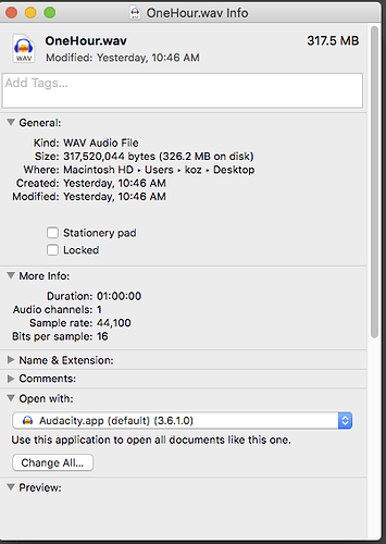

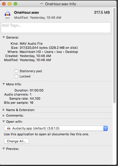

We still need the one last piece of this. Find out what you really have.
Macs have a Get Info tool.

WAV is a “container” and it can legitimately contain compressed audio in various compression formats, but it’s rare to run-across it and Audacity may need FFmpeg to decompress it.
Or sometimes it might simply have the wrong file extension.
File size can be a clue but you need to know the details. The are 8-bits in a byte so for example, uncompressed “CD quality” audio is:
44.1kHz x (16-bits/8) x 2-channels = 176kB per second, or about 10MB per minute. (Imbedded artwork will throw off the calculation.)
