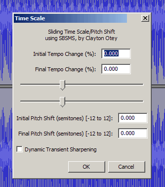

Is it possible within the audacity program, to create an envelope within which one can change the speed so that for example, it starts off at normal speed but by the time it gets to the end of the envelope, the speed has doubled but this is performed gradually over the length of the envelope?
Could try “sliding time scale / pitch shift” effect in Audacity 1.3 “Effect”…
or this “warping” plug-in here … https://forum.audacityteam.org/t/how-do-i-avoid-aliasing-artifacts-on-glissando-effect/16712/2
The “sliding time scale / pitch shift” can change speed whilst preserving original pitch, (but introduces conspicuous artifacts ).
The “warping” plug-in does not preserve pitch when the tempo increases: pitch increaes with speed, (but less artifacts than the other effect though).
