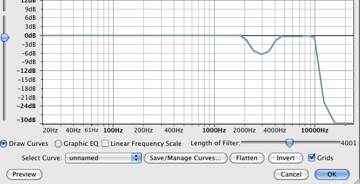

I suspect you can fake it by dipping the sound response a little at 3KHz and then dropping the overall response starting at 10KHz. That will sound interesting.
Effect > Equalization

Each of those dots on the curve is a control point. Click and drag. Watch the frequencies along the bottom and the gain numbers down the left. The blue/green line is a rubber band. The design center is to make the music less forward and harsh. You might like it.
If you get totally flummoxed, I think I remember how to send you the curve.
