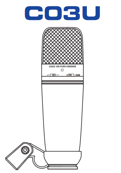

Let’s see what the instructions say.
– Make sure you do not have -10dB selected with the switch on the front.
– Make sure the pattern control on the rear is in the middle (kidney-shaped pattern).
– Make sure you are performing into the flat front of the microphone not the top. You should be facing the microphone as in the attached pix.
– Close Audacity. Apple (upper left) > System Preferences > Sound > Input: Select “CU03” (the microphone). Slide the volume control up and down while you speak and it should be possible to max out the bouncing blue ball sound meter. At the very least, it should be possible to make the volume very, very much louder and softer. You may not hear anything. I’m just interested in the blue meter. Where do you get stuck if at all?

One more. Make sure the little green light on the front is on and you are not going through a USB hub. USB audio needs direct home runs to the computer.
