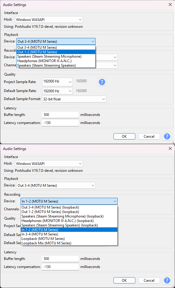

Since this question was relevant before I actually bought my MOTU audio interface but couldn’t find satisfying answer back then, I want to share my findings for people who are in similar situation.
At least, MOTU M4 works flawlessly with Audacity 3.7.7 on a Windows 11 computer. I was not sure about relevance of ASIO interface support so I tested the MOTU M4 interface both with Audacity that didn’t have ASIO support and with one that I compiled with ASIO support. Good news is that both Audacity versions recognize and work with MOTU M4 when MOTU Windows drivers are installed (and the MOTU M-Series application is launched on the background).
I strongly assume that because MOTU M4 works, M2 works without issues, too.
Here are some screenshots taken on my Audacity 3.7.7 Audio Settings window, MOTU M4 interface turned on:
Available playback & recording devices:
I recorded some audio with Inputs 1/2 (stereo) and 3/4 (stereo). Stereo recording works, too.
Just remember to turn off USB power saving on Windows as it may cause Audacity to hang during recording sessions (because MOTU device is lost, I assume?). Disabling the USB power saving feature resolved freezing issues, at least for me.
