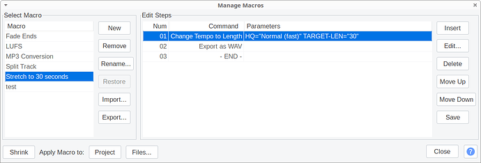

The best way to send feature requests is to add an “Enhancement Issue” to Audacity’s GitHub: Issues · audacity/audacity · GitHub If the developers like the idea, than the feature may be added eventually, but it is unlikely to happen any time soon.
In the mean time, I like your idea, so I’ve made a plug-in for the purpose that you describe. It’s called “Change Tempo to Length” and it can be downloaded from my blog: Stretching audio to length | AudioNyq
To use the effect in a macro, the audio that you want to stretch must be selected, then apply the effect.
This shows a basic macro that uses the plug-in to batch process files, stretch each file to 30 seconds duration, and export as WAV:

Our station’s volunteers have started using ‘Change Tempo to Length’. We have cleared a backlog of almost one thousand interviews. This would have taken almost a half a year of daily work. With your plugin it took only one volunteer 4 hours. Thank you sooooo much!!!
Bob
Plus half a day for me to write, test, document and upload the plug-in. That’s a good return on the invested time - glad I was able to help :slight_smile:
