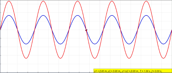

Even if the unwanted noise was a constant tone of constant volume , (rather than unpredictable random noise) , the phase would have to match for destructive interference.
Red line is the result : it only goes flat , (i.e. silence) , when when red and green are anti-phase.
http://en.wikipedia.org/wiki/Interference_(wave_propagation)#Mechanism
