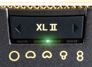

Attached is a modern microphone that can switch to a Figure Eight pattern. Look for that ability in a microphone you plan to buy.
And if you don’t care about echoes or room boom and only want to interview one person, then your’e good to go.

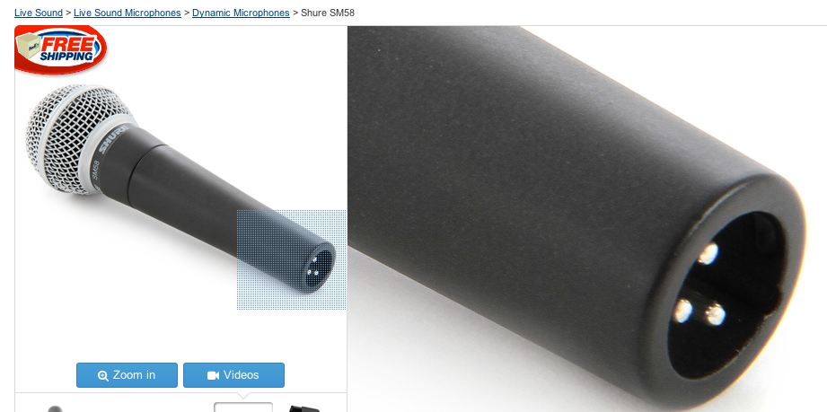

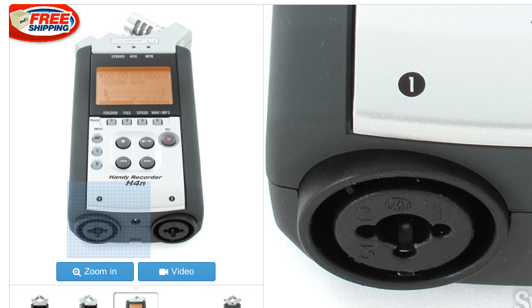

I can’t speak to the other Zoom products, but the H4 and H4n have XLR3 female connections in the bottom suitable for any microphone that accepts XLR. This includes microphones that require 48v Phantom Power — sometimes referred to as “P48.”
USB microphones are completely different. They plug right into the computer and don’t use memory cards, XLR cables, Phantom Power, mixers, recorders or anything like that. They’re self-contained except for the computer. They’re also aggressively nonexpandable and they’re forever tied three to six feet from the computer USB connection.
The Zoom H6 has options that allow it to accept up to 4 XLR microphones and the H2 has the ability to accept a separate “computer microphone,” not a pro/broadcast microphone.
The Tascam DR40 will work with XLR microphones.
