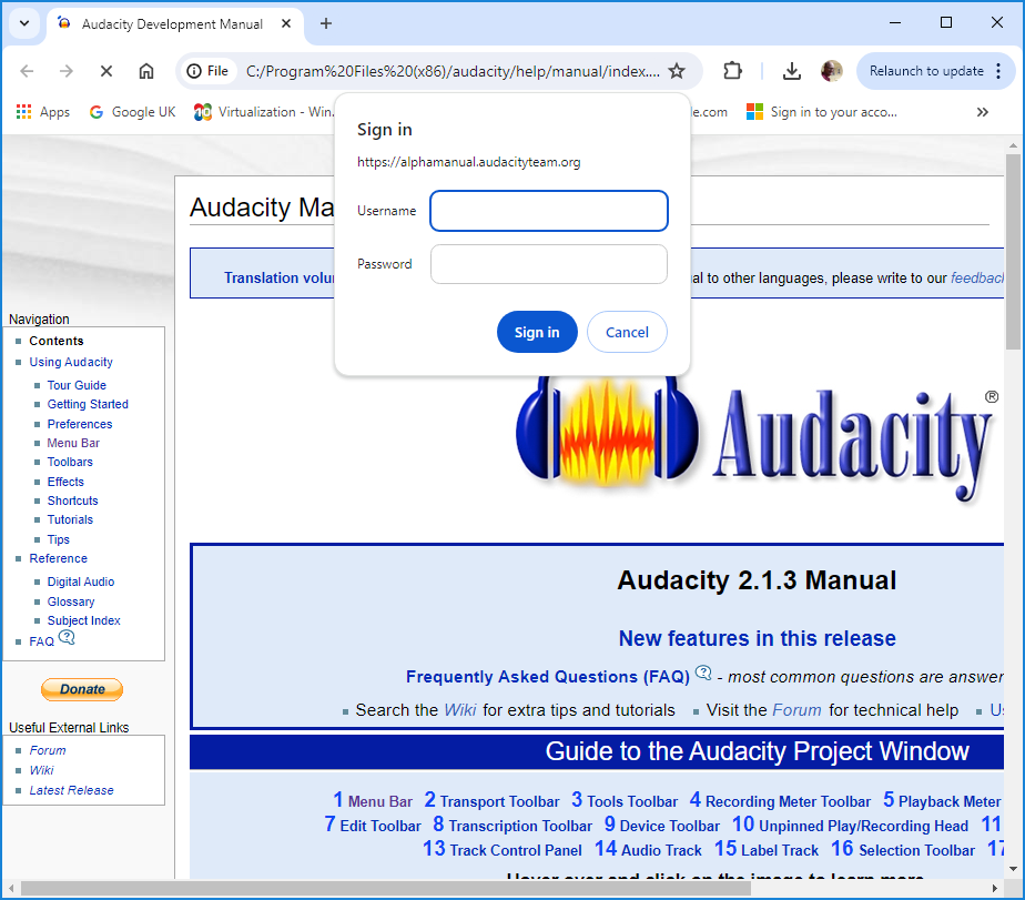

To make sure I had not made a mistake, I uninstalled Audacity from XP, downloaded Audacity 2.1.3 from FossHub and installed it on both Windows XP and 10 with the result (both OS) you can see on the attached screenshot, the manual is included, but with the pop-up window requesting username and password visible. Maybe later versions do not require username and password, but 2.1.3 certainly does.

It appears that the manual contains an html error that is trying to get some content, possibly an image, from the on-line “alpha manual”. However, the alpha-manual is no-longer open, so the server is asking for a log-in. I’m not sure what precisely it is looking for, but it doesn’t appear to be anything important - my guess is that it’s probably just a logo gif or similar. Just click “cancel” and you should be able to browse the manual normally.

Regarding the pop-up windows, they do pop-up for every page, but can be cancelled every time, so that the page can be read. As soon a a link is clicked, it does go to the new page first, then the pop-up window appears. It is, thus, not just to close it once, and then everything is fine. It has to be done for every page.
However, albeit this is very inconvenient, it is possible to read the manual this way. If you, or someone else happens to know the requested credentials, it would be better.
