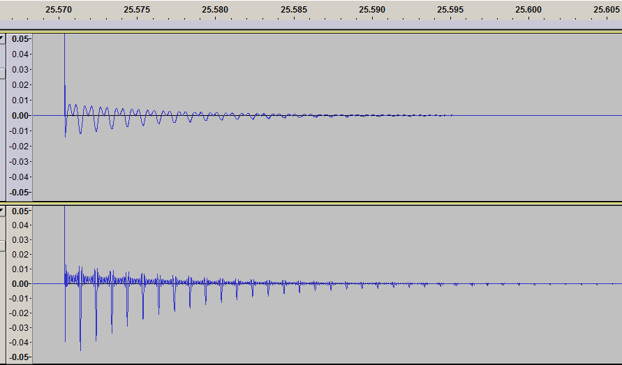

the more notches are applied, the more ringing artifacts are generated on transients …
If you want to squeeze-out the optimum-quality, use the least amount of notches.
