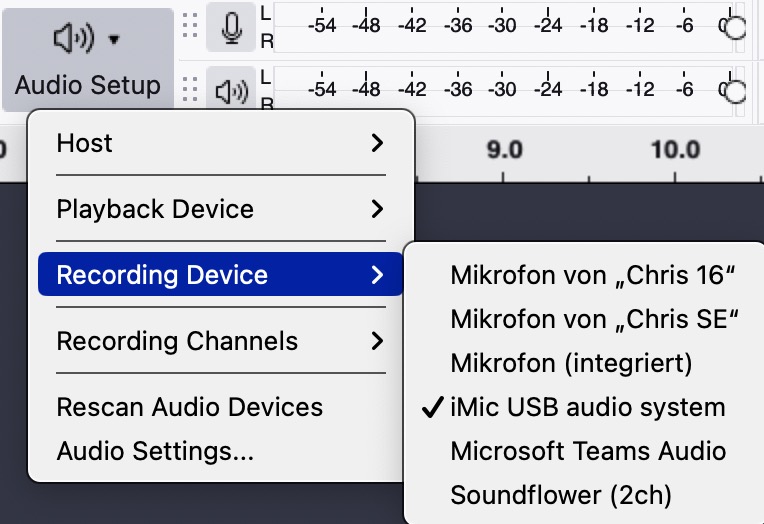

You need to select something with “… USB …” for the input source in Audacity.

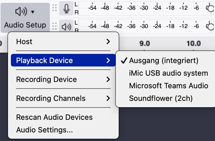

Playback device is your standard Mac sound output.

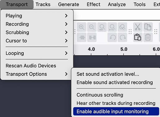

You can activate “Play-through” in Audacity to hear on your Mac (or earphones connected to the Mac) what you are recording: Menu “Transport → Transport Options → Enable audible input monitoring”.
The cassette is the recording device, as is the microphone. It is the device Audacity records from.
The built-in speakers are the playback device. It is the device that Audacity plays back to.

I didn’t allow permission to use the microphone on software install. I have now allowed this following your instructions and have got it working by using Playback: Built In Audio and Recording Device: USB PnP (not Built In Microphone). Thanks billw58.
Hey romontschun. The Mac version is in the subject title. As noted in thread I now have got this working. Enable audible input monitoring was a very useful tip thanks. I just need to check the import works ok and I think I am up and running!
