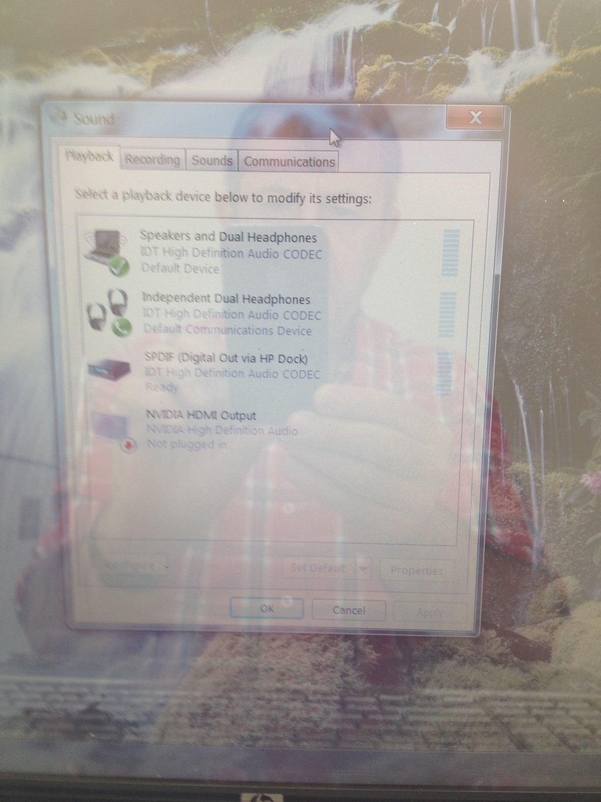

Thanks Steve - I had a look but it doesn’t look like the device is recognised by Windows (see pic). It was working perfectly well before, so I don’t know why it isn’t now. Any other ideas? Mark
You need to look in the “Recording” tab (your picture shows the “Playback” tab).
If the USB device is not recognised by Windows then you will not be able to record from it.

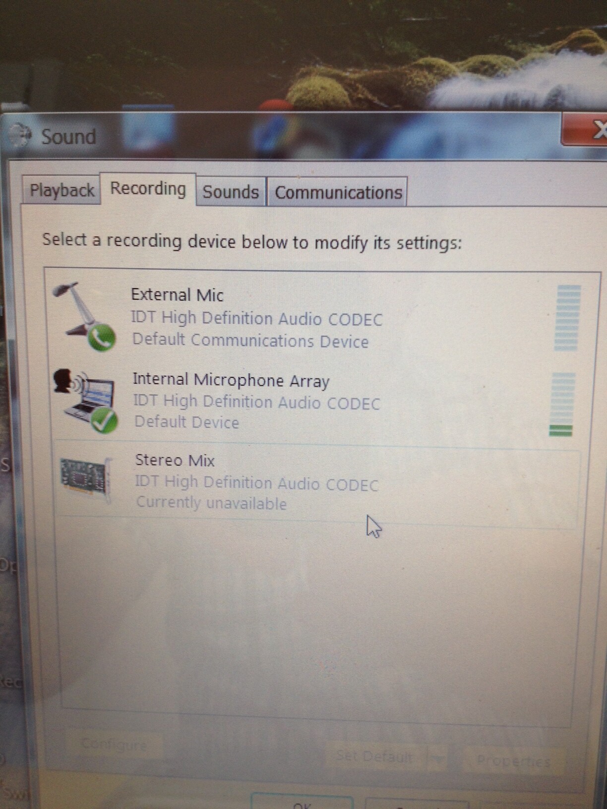

@wristy151966: You can take a picture of the whole screen using PrtScr and of a dialogue using ALT + PrtScr. Then open Paint, paste and save as a PNG image.

Hi Steve/Gale, it looks like it isn’t recognised by my PC as a recording device (see pic). Since the USB lead works with other devices and in other PCs (I’ve already checked this), presumably that means that the socket in the T2MP3 device is no longer working? I don’t want to use the other audio option you refer Gale as the sound quality won’t be good enough. Mark
Is the USB cable attached tightly? If you have a different USB cable I recommend trying it.
Otherwise all you can do is try all the steps in the green panel “Detecting USB and Firewire devices” here: Audacity Manual.
