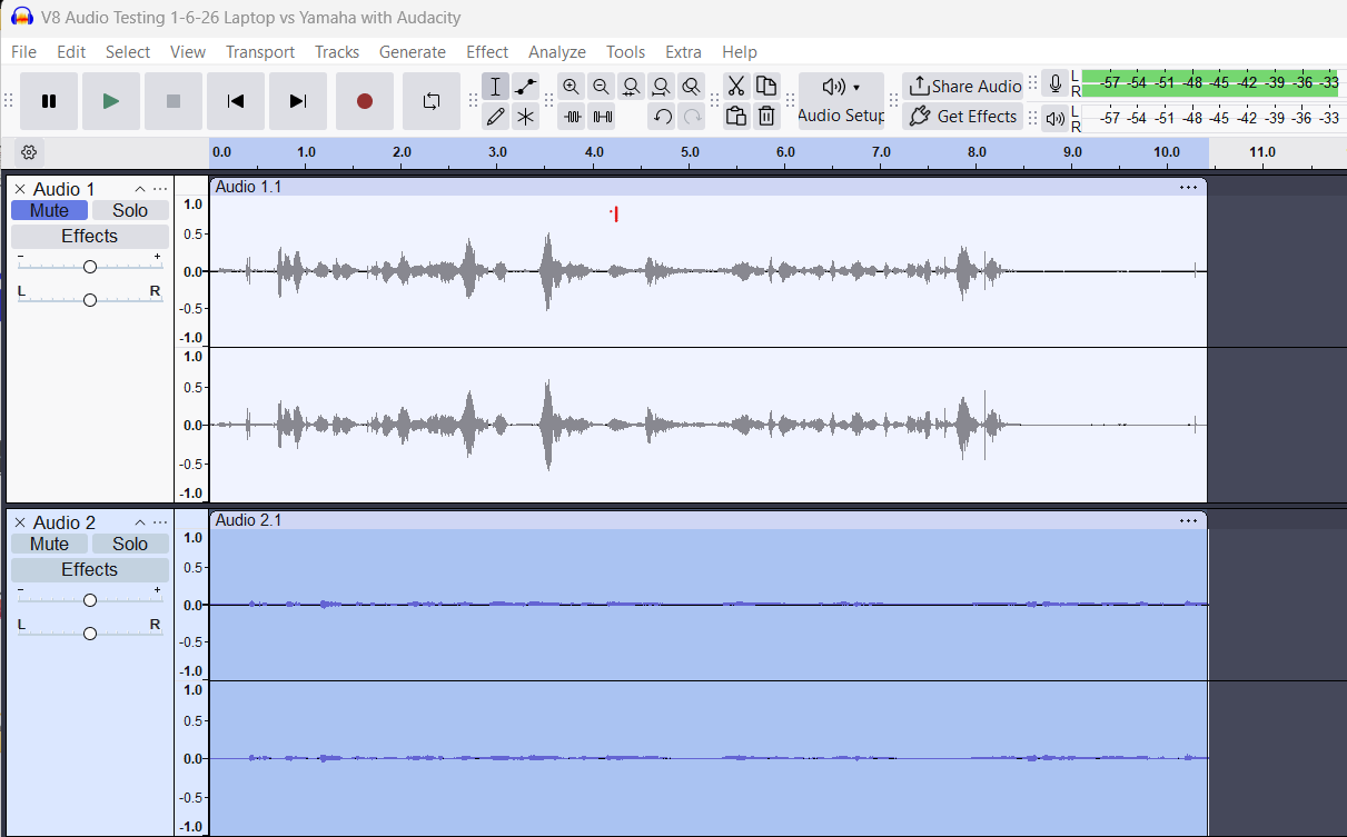

Hi. Thanks for taking my question. I’m running W11, Audacity 3.7.7, Yamaha MG10XU. Output from Yamaha is at perfect levels however, audacity register a +29-37. Any idea why. If I push the mixer to the max, I get noise. If I push Audacity, I get noise. Thanks for your help

Hi Doug, Again, sorry for the delay.
T1: I’m using WASAP /Yamaha Steinberg USB Driver, and with Think Pad’s mic and speakers. No enhancements. Aud waveform is good as is the playback vol.
T2: Wasapi/Steinberg,Yamaha mg10xu mic @ -06 - 0. Speaker is still Laptop’s. Why is the waveform so much smaller? In order for me to get the same level of playback, I need to increase aud’s slider on the left to +8. If the mixer is outputting a strong signal to Windows, the property sheet says 0.0db, why does aud see it as so low.
Thank you very much for your help.
