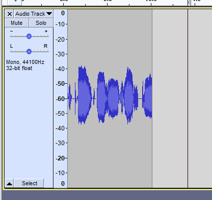

When referring to “0.5 on the Audacity waveform scale” do you mean the the scale at the side (Vertical Scale context menu). Could you do this and give feedback. Highlight the vocal recording, click on EFFECTS and click AMPILFY - note the reading, and click cancel. The data will reveal how much the recording need to be amplified by to reach 0.00db.

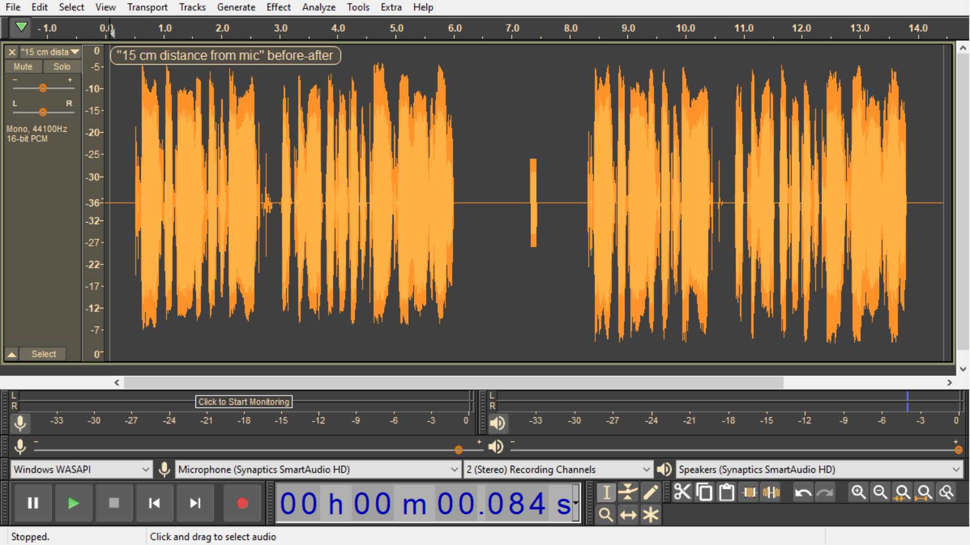

Please see attached. I did it following the instructions in the previous post link. That is speaking at 15cm distance from the mic (already quite close for my preferences). I also attached two screenshots of the same recording in dB scale and linear scale. Compared to other sound imported like music or other recording it seems very “small” on the scale.

If that’s as loud as it will go, it’s possible to amplify it in Audacity,
but noise reduction will be required, because the hiss level is high, relative to the voice level,
(aka low signal-to-noise ratio).
Thanks for the graphic. Its seems that the waveform is shown in db and looks like -40db. How many clicks (steps) do you need to do on the microphone to reach max. If its, for example, 10 incremental clicks then lower down about 7, meaning that the audio gain level ON THE MIC is at 70%.

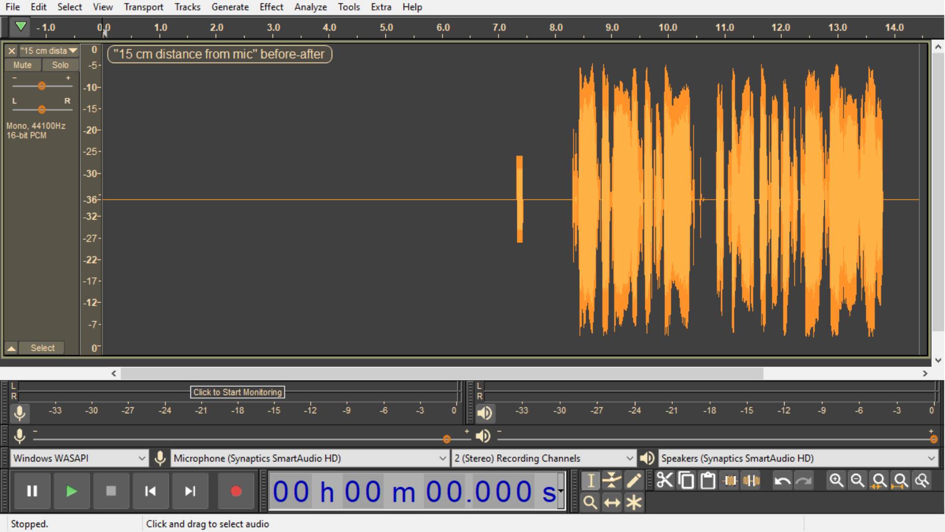

The audio you uploaded is in two sections, divided by the bleep. The first very quite (-37db)and the other absolutely perfect. The first part before the bleep I NORMALIZED to -6db. Then COMPRESSED using Audacities default settings. There is now little difference between the two. I exported the clip as an mp3, VARIABLE 45-85 kbps. I done this as a quality test - if sounds good at those particular settings, then it is good!
