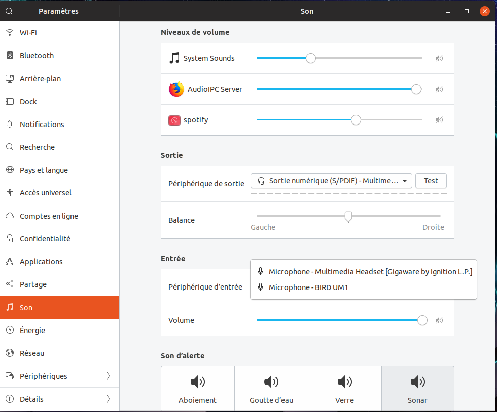

here are the sound preferences from the pc (mic is detected as set as default)
The short answer: Your Ubuntu sound system is broken. Have you uninstalled PulseAudio? PulseAudio is the default sound system in Ubuntu, but no sign of it in your audio device info.
How did you install Ubuntu 19.04?
At least it used to be - appears that Ubuntu have made changes to the sound system, but I’m uncertain at this stage what they’ve done. I do see on Google that quite a lot of people are reporting audio problems in Ubuntu 19.04.
