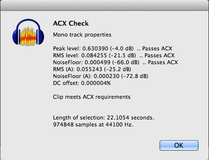

The desirable volume level (on the blue waves) is peaks between 33% and 50%. It’s a constant source of irritation that the bouncing sound meters and the time line are in different numbers. They should not be and there is a Request for Change in Audacity to make them match. Those two percent values work out to -6dB and -10dB on the sound meters.
So if you can generate blue wave peaks up to 0.3 (30%) on occasion, that’s probably enough.
Only the top three numbers in ACX-Check are useful in AudioBook Reading, and then only the dB values. From top to bottom, overload distortion (Peak), overall loudness (RMS) and how loud is it when you stop reading (background noise). Overload and Noise are limits. Loudness is a range.
In the ACX-Check panel I posted, the Noise value was -60.1. The restriction is -60. That means if anything at all goes the slightest bit wrong, the presentation will fail. And that’s after I sent the work through very serious noise reduction.
A very quiet recording environment is really important.
