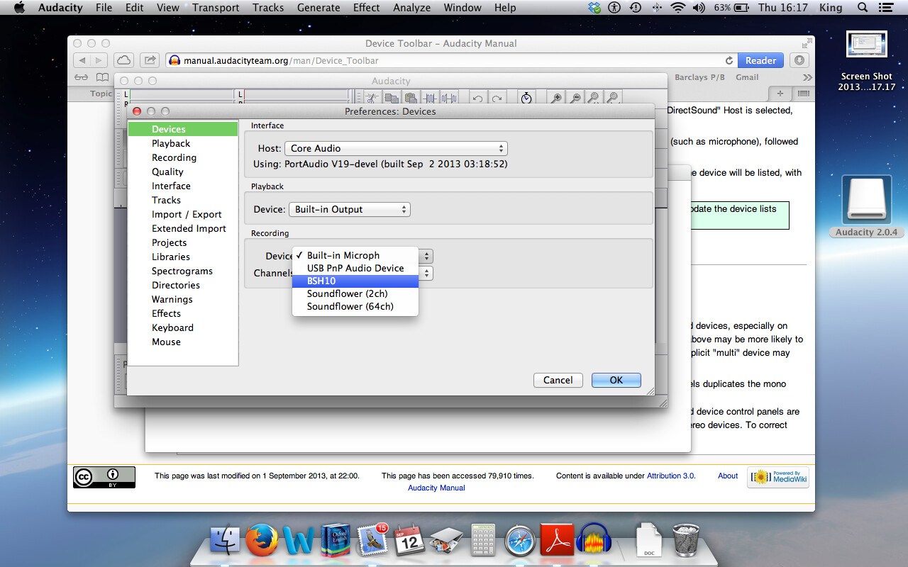

Thanks Bill,
I have tried all that you said, please see the attached picture of the outcome on my computer, I couldn’t see the USB Audio CODEC at in all the preferences.
and I couldn’t find the particular audio cassette capture that I use as well.
I hope this will help you to direct me further on what to do

In the “Recording Device” in Audacity Devices Preferences, try choosing the “USB PnP Audio Device”.
Leave the Playback Device at “Built-in Output”.
Note the correct link for the Manual Device Toolbar page is http://manual.audacityteam.org/o/man/device_toolbar.html .
You can use the link you are using but as we work on 2.0.5 the Manual you are looking at will change and then won’t fully relate to 2.0.4, which could get confusing.

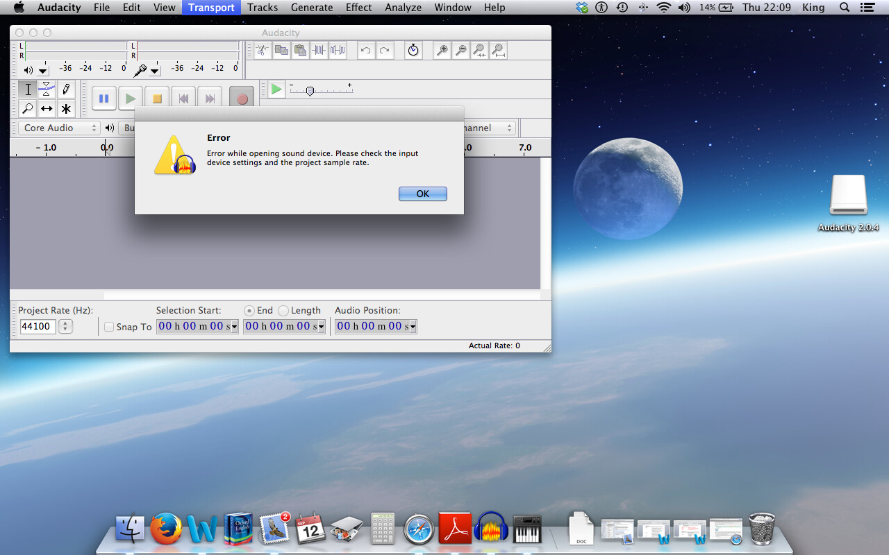

Hi Gale,
thanks for your help, i have done exactly what you said, please see the attached file for the error message recieved from doing that.
Even though it could be frustrating trying to get through this, but i guess i would still hand on, until i obtain a required result.

If you disconnect the cassette device from the computer, do either of “USB PnP Audio Device” or “BHS 10” get removed? We can only guess what they are, unless you tell us.
If none of those get removed, then your cassette device isn’t recognised by Mac yet, so you will need to address that.
You can try another USB cable. USB cables supplied with USB audio gizmos are often faulty.
Then try playing a tape and see if you get the bouncing meter in Apple Sound Preferences as described on Bill’s page.
Or you can try setting up the cassette device in Audio MIDI Setup. See Bill’s page http://wiki.audacityteam.org/w/index.php?title=User:BillWharrie/OSX_and_USB_input_devices#setup .

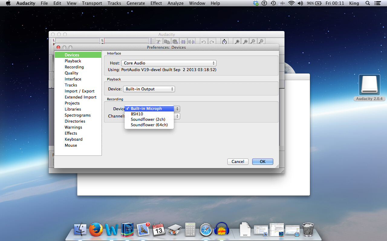

Thanks Gale,
When the cassette device is disconnected from the computer, the “USB PnP Audio Device” get removed from the ‘Recording Devices’ see the attached and
what does that mean?

Then you have identified that “USB PnP Audio Device” is the USB cassette device.
So try quitting Audacity, unplug BHS10 (which I assume to be wireless headphones) then plug-in the cassette device and restart the Mac. Then we can eliminate the wireless dongle as the problem.
Then play a tape and check the meters in Apple Sound Preferences. If there are no bouncing meters then probably your device cannot record audio using its current USB cable. If you set up the device in Audio MIDI Setup using Bill’s page and the meters still don’t bounce, then your device definitely can’t record using its USB cable.
So then try changing the cable and try again.

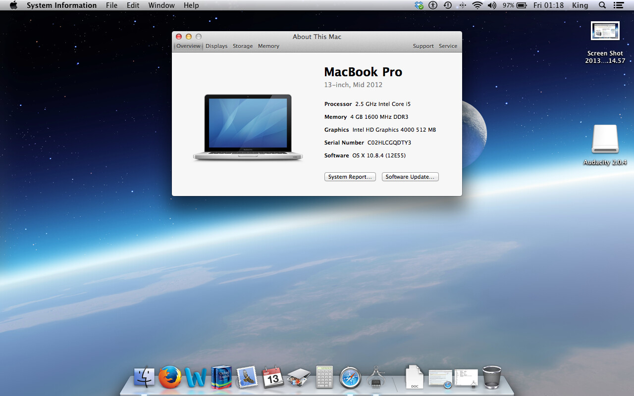

What is the make and model number of the cassette device? Does this cassette device have a place where you can put headphones in?
What is the make and model number of the Mac (exactly) and what year did you buy it?

Thanks Gale,
I attached the information required,

According to http://support.apple.com/kb/sp649 your model only has a built-in microphone, so it is not an input you can attach a line-level cable to from the tape deck headphones.
Your headphones port can be used as a microphone if you have an Apple headset, and could be used for an external mic with a suitable adaptor, but that is if no value to you.
