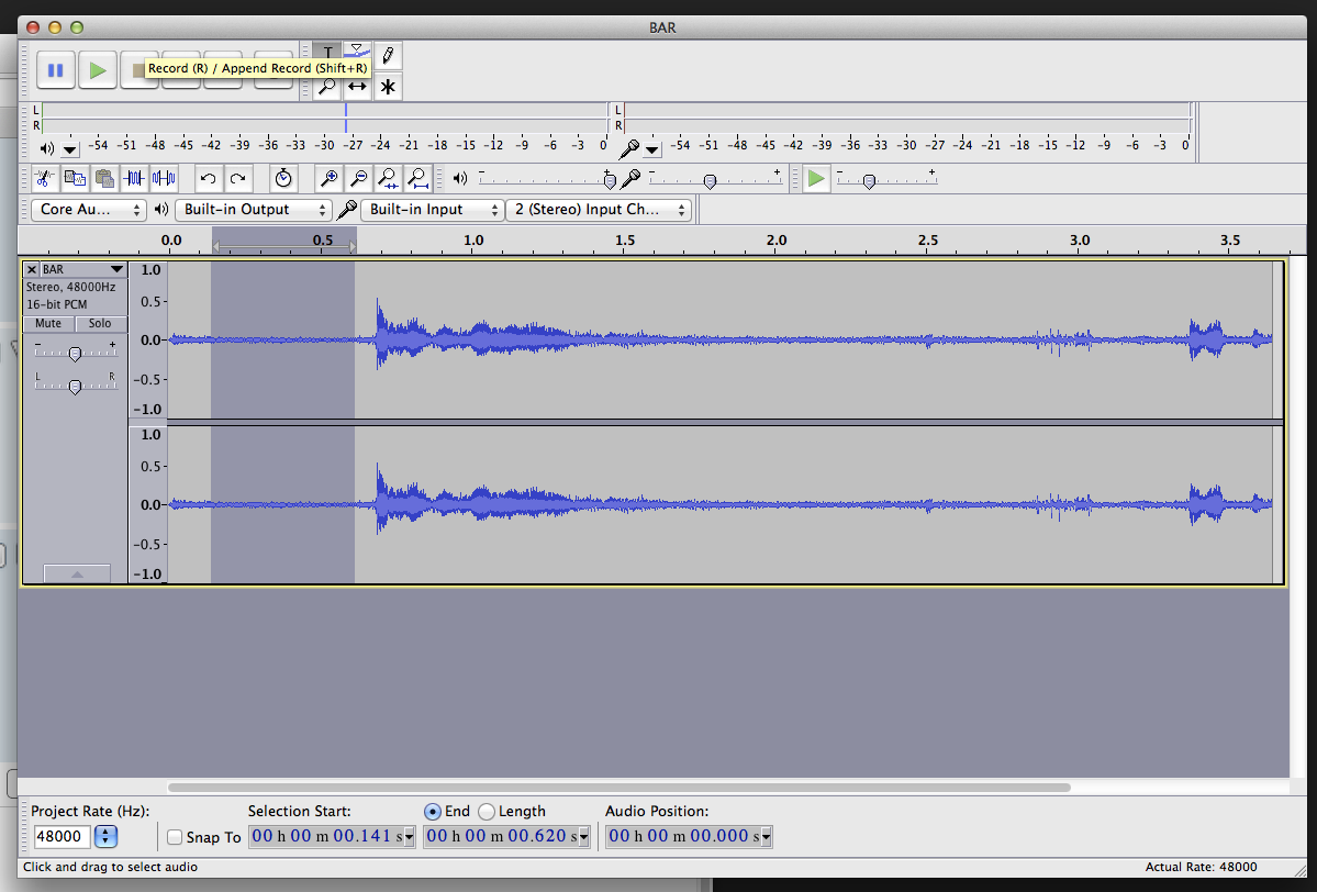

If that’s close enough, then we’re done. If you want to suppress the crowd a little bit, drag-select the portion of your clip as in the first picture. Effect > Noise Removal > Get Profile.

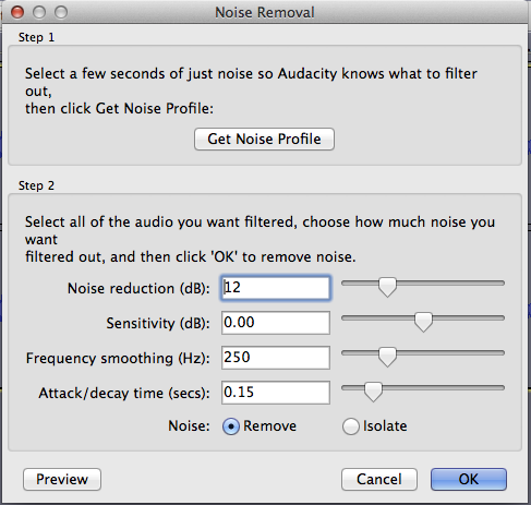

Then select the whole show and Effect > Noise Removal: use the settings in the second picture > OK.

The Noise Removal step is delicate and will only work as long as the crowd noise doesn’t change. If it does, you have to go through and get a new profile with the new crowd. The application settings in step two should stay the same.
