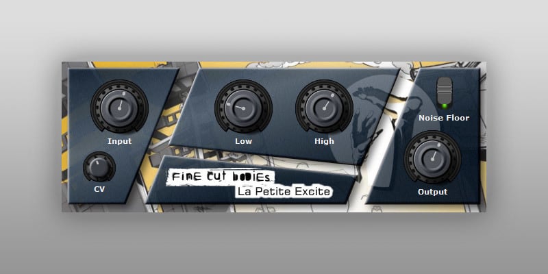

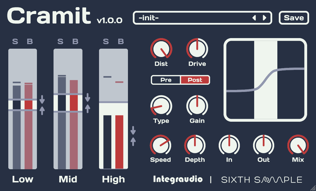

IIRC Chris’s is a single band compressor/expander.
Free multi-band expander plugins are available that do a better job …
(2 bands. Only expands upwards).
(3 bands, compresses & expands, upwards & downwards ).
