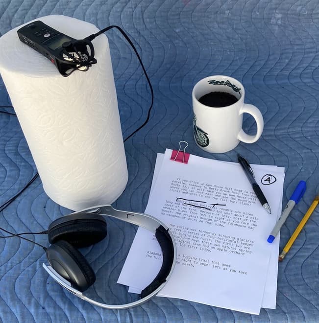

Which one? This is my Zoom H1n which I rather like.
When I power it up, it tells me in a little window lower-left that it’s planning on using 44.1K at 16 bit. What does yours say?
