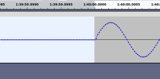

To test the Rhythm track, I generated 6002 seconds of click track at a tempo of 92 bpm.
6000 seconds = 100 minutes, so if Rhythm Track is accurate, the first beat after 1h 40 (100 minutes) should start at exactly 1h 40:
metronome
This proves that the Rhythm Track effect is extremely accurate. However, there is no guarantee that your computer plays audio at exactly the correct speed. The playback speed accuracy depends largely on the sound card / audio device. If an audio file has a sample rate of 44100 Hz, then the sound card should play 44100 samples per second. If it plays more or less samples per second, then the tempo will be off.
