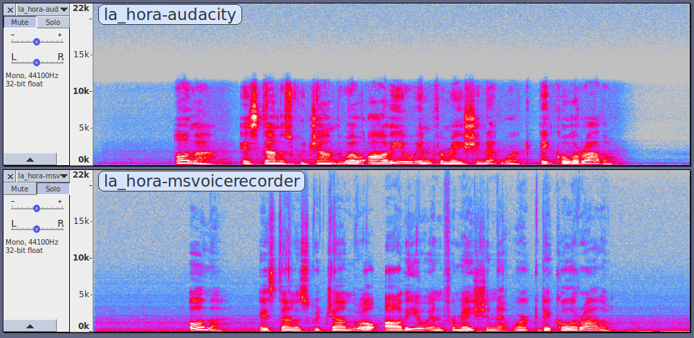

I can hear what you mean, and also observe a huge difference in the spectrogram view. Something is process the heck out the Audacity recording.
Assuming that the recording from Audacity is just a straight recording and you have only recorded and then exported as WAV, then you need to look at what else is running on your computer. Open the “Task Manager”, and identify everything that is listed (Google can be a big help with this).

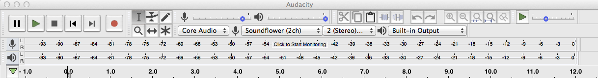

What does the recording device say in the little window next to the microphone?
