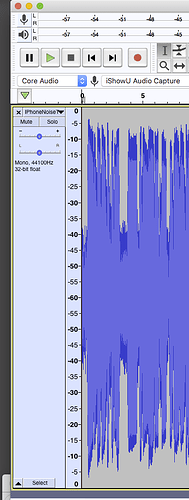

i’m trying to understand how to read the waveform dB in audacity, and I cannot for the life of me understand how to read this. i’ve tried scouring this forum and just googling, and wat i did get is that the waveform db in audacity is relative/a ratio and it does not provide dBSPL. beyond that, i do not understand. ![]()

Here are two examples. First one i had a sound meter reading. Second one, i did not. The third is birb chirps and trills. These planes are freaking loud and clock in >65decibels at the loudest. i dont even live next to the airport!
