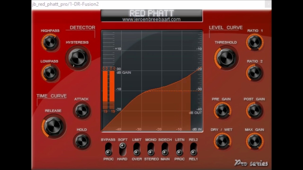

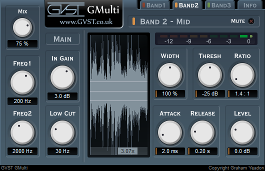

There are free VST plugin compressors which work in Audacity which work in real-time,
so you can play around and quickly get the effect you’re looking for, e.g. …

I’ve never seen a Nyquist plugin which works in real-time.
I have these 3 real-time compressor plugins in Audacity on Windows, (they are free) …
NB: Only 32-bit plug-ins will work in Audacity on Windows, even if your computer is 64-bit.
