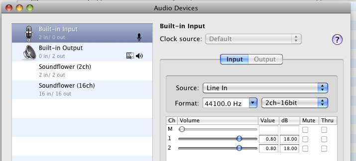

Just for giggles: Go > Utilities >Audio MIDI Setup
Select your USB device from the listing on the left. USB Something Something?
You should have a control panel similar to the one I posted. Your two individual 1 and 2 sliders should be dead even, gray, and immoveable. Is that what you have?
Hi Koz,
It’s all greyed out, it won’t let me change.
I just unplugged the uca202 and plugged in the ART (to a different USB jack). Is Mac/Midi/Audacity reading the old uca settings? Do I need to shut down iMac and restart?
