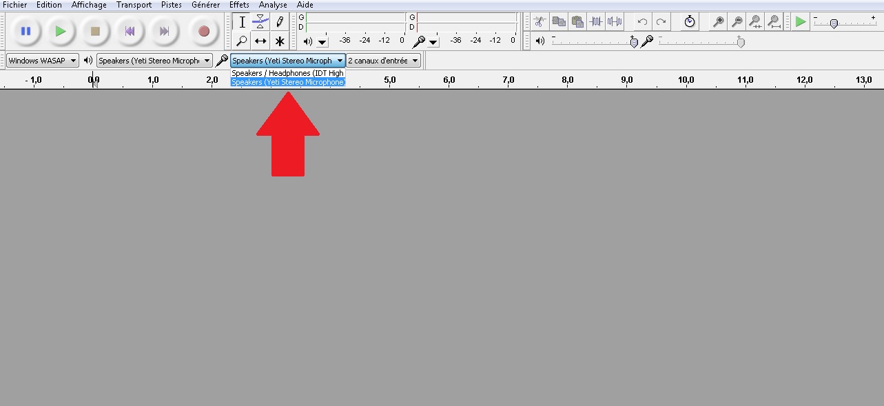

When I go on Audacity to record, the Yeti appears in the list of input and output devices (see pic 1). So far so good.
But then, when I hit the record button, the red arrow on top of the tracks doesn’t move, and nothing is recorded.(see pic 2)
What’s going on?
I have connected and disconnected my mic many, many times, and tried with different cables, with and without an USB hub. And I rebooted my computer several times too. Nothing works.

Look in your screenshot. You have the host in the first box in Device Toolbar set to Windows WASAPI. Change the host in that box.
Thank you. I changed it for DirectSound and now the cursor moves but nothing is recorded. I had a look back to the link (http://manual.audacityteam.org/o/man/faq_recording_troubleshooting.html#pauses) koz sent me and found a section for that too: “Why do I get only a flat line and no sound when I try to record?”

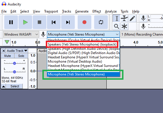

I know I’m a million years too late, but I ran into this exact issue and the solution is frustratingly simple.
If you look back at OP’s picture you’ll notice that they have selected the Yeti option preceded by the word “Speakers”. You need to select the option with the word “Microphone” in front of it.
