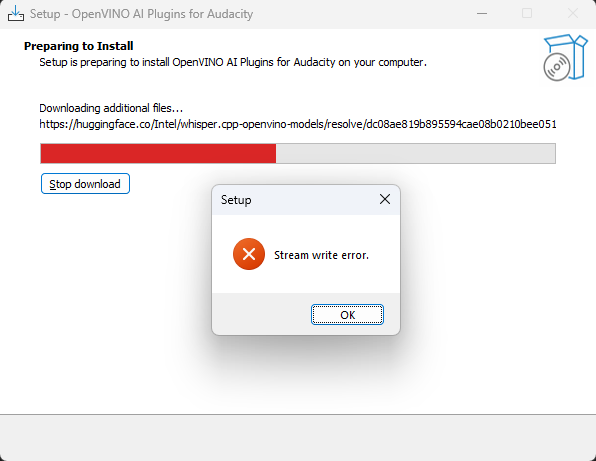

This was the error when I tried installing the openvino plugin on 3.6.1. I didn’t save a screenshot of the error code on my first installation (on the 3.6.2) unfortunately but I vaguely recall it was a similar error.
Thanks, now I see what you mean… an error while downloading the models during installation.
Out of curiosity, what version of windows are you using?
I’m currently on Windows 11.
Hmm, strange. At this stage of the installation, it’s downloading a few (large) AI models from huggingface.co – perhaps there is some current disruption on the server side. I can try it on my end in a little while.
