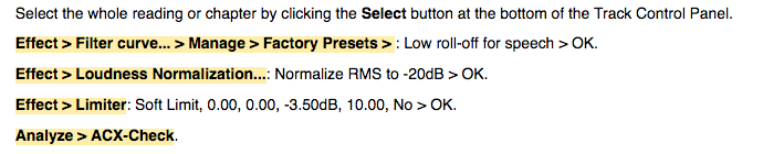

This is an excerpt from that post.
Please note “Loudness Normalization” has a display bug. You and ACX want RMS, but the display value doesn’t always follow you. Switch away from RMS and then switch back. Then put in -20dB > OK.
