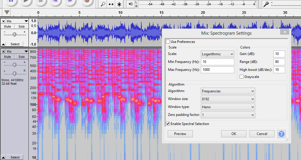

(rhythmic) bassy thumps are easier to see on a spectrogram than to reproduce …
The spectrogram could be evidence that the thumping occurred at particular time,
but it’s not evidence of how loud the thumping was: playback could be louder than the original sound.

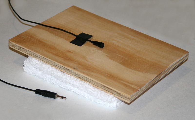

placed mic about 6ft high used pressure zone mic technique
Exactly right. There are all sorts of tricks and techniques for recording sound. If you’re intent on very low pitch sounds, your pressure zone base needs to be pretty big.
Voices:
That will handle most voices, OK, and it has all the advantages of pressure zone (be sure to mount it on a towel), but it loses its moxie (technical term) as the pitch goes down. I can’t find the illustration, but a full fidelity base plate is 30 inches (760mm) on a side. I mounted one of these in the middle of a conference room table once (on a towel) and it worked very well.
