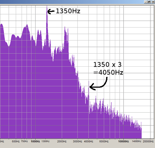

The “3950-4050Hz” peak appears to be the third harmonic of the 1350Hz peak …

Sine waves (pure whistle) tend to only have one peak on the spectrum. Square waves or waves with clipping or overload damage have harmonic energy at odd numbered frequencies. 60, 180, 300, etc.
It’s one of the ways distortion analyzers work. Suck out the original pure sine wave and anything left is either distortion or noise (or both).
