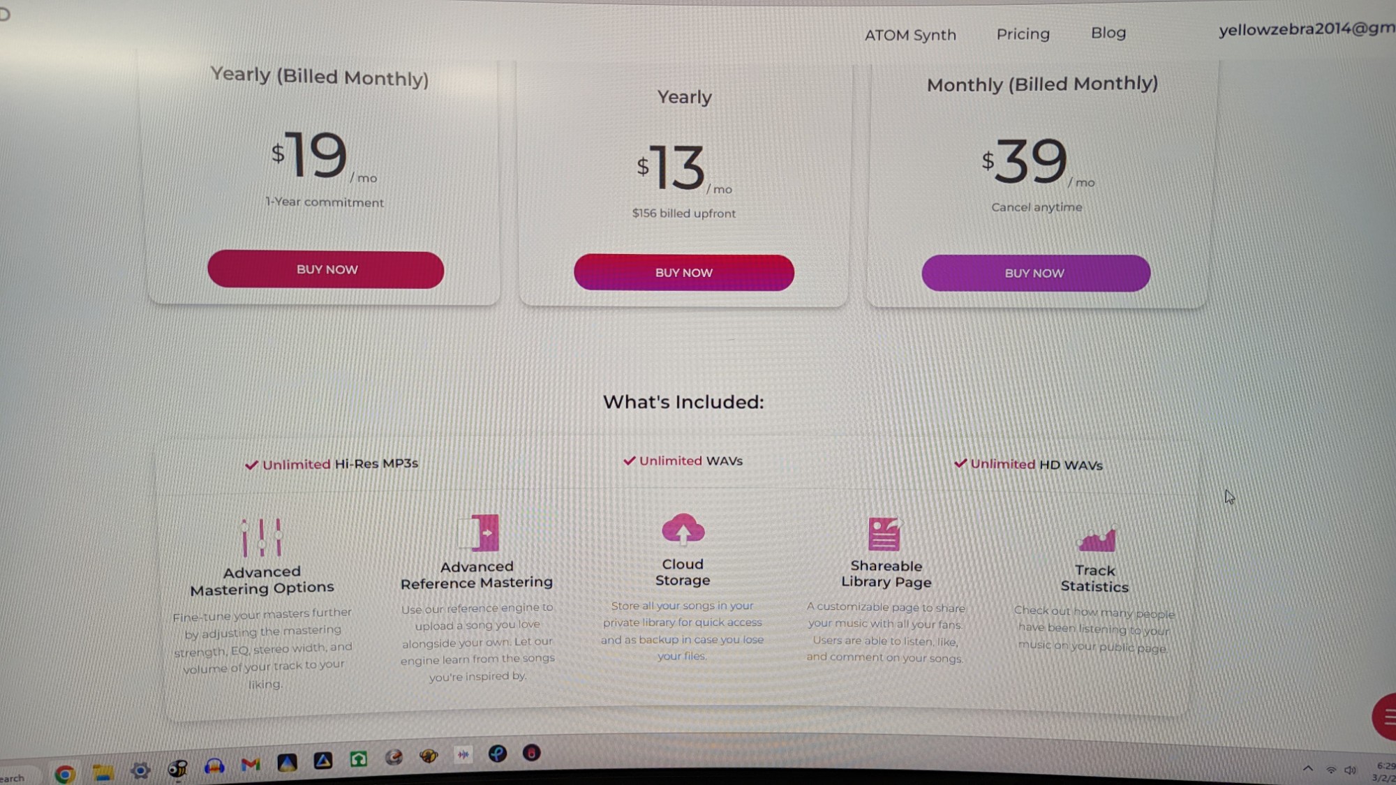

Wow! Absolutely - wow! I took a previous remix and dropped it in to E-Mastered and I cannot tell you the difference in sound. This is EXACTLY what I’ve been looking for! There’s a screenshot of kind of what is happening… I’m going to do the $19 a month deal… I do not offer thid service myself or anything like that. I’m not making money off this. Just thought I’d share because with a couple of clicks I’m pretty blown away

Not sure if it’s allowed but I’m posting a video where I’ve done an A/B comparison after using this site to master one of my remixes. I’m VERY pleased with the results. Thought I’d post a link (it’s not public only those with the link can view it) in case anyone else needs this info. I want to be clear that I have nothing to do with this site nor profit from it all but I’m going to assume that others might be looking for a really good and easy solution.
You may as well be working for their competitors :laughing: : if that’s all it does its not worth any money.

I will check that out for sure…I don’t think emastered is worthless. A simple listen to my tests show that it certainly improves the project. You are able to adjust mastering intensity, compressor intensity, equalization intensity, stereo width, volume and equalization. You can even upload a reference song along with the song you want to master. According to them doing so “will serve as a sound guide for the mastering engine. eMastered will analyze the file’s sonic identity, and apply that learning to your own master.” Whether it did that with my reference song - who knows but there is definitely something good that happens when using it. Simplicity is the name of the game for some folks that can do quite a bit but have yet to learn the process of mastering. But I’m not one to shy away from a tool before using it so I’ll check out what you posted. I would encourage you to do the same with emastered. You can upload a file and listen to the differences without paying anything.
